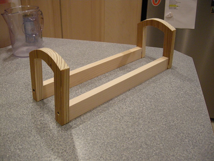

Thought I'd take a stab at Howard's castle-tunnel project, making a few changes along the way. Haven't gotten too far, but beginning with the tunnel underpinnings:
Castle-tunnel project
HL project a.jpg (153.44 KiB) Viewed 297945 times
Lengthened the tunnel by 4-5 inches, reduced the pitch of the portals, and modified the arch a bit. I also made it slightly narrower, but a half-inch taller. I plan to use a bit of foam-board in place of wood to cut down on weight. More to follow.

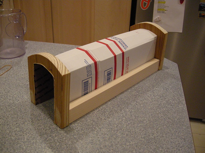

I got the liner fitted over the weekend, but it was a bear:
Tunnel liner
Tunnel liner
HL project b.jpg (152.25 KiB) Viewed 297934 times
I was going to use cereal box cardboard for the liner, but couldn't find any that was long enough (possibly the result of me lengthening the tunnel by 4-5 inches). Reverting to corrugated, I had difficulty getting it to take a graceful arch form. I used an old shipping tube as a sort of form, but the cardboard had a tendency to bend incrementally rather than in a nice curve. The ends look okay because they are glued to the form of the portals, but at the middle the ceiling is a bit notchy.
The other problem was I neglected to take into consideration the tilt at the top of each portal caused by the pitch they were cut on. When I glued in the liner at one end, a noticeable down-hill angle resulted. I had to force-fit the opposite end using a quite a bit of Titebond and a half-dozed C-clamps. The combination of the force-fit and the poor arching at the center resulted in a very slight hump. Twenty-four hours to dry, then I trimmed off the excess corrugated.
Presumably, the next step is to manufacture a couple of supports that sit over and atop the liner. These will hold the base of the structure that goes above. I'm thinking of using one-inch foam for these, but if that isn't strong enough, I'll use some scraps of one-by lumber. I've left the liner unattached to the side rails in case I need to do a bit of fiddling to get things to fit. When this bit is done, I'll glue the liner to the side rails.
Not to get too far ahead of myself, but I do have one question. How do you guys separate corrugated to get at the rippled bit that you used for the building's roof and some of the trim? Or is that material from somewhere else?

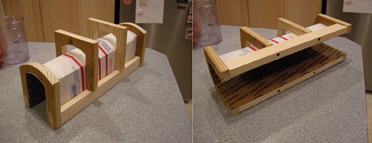

A bit more progress. I cut a couple of supports that I was going to fit snug to the tunnel liner and then build up, but then I decided I need more height for the plateau anyway, so I just glued them in and ran 2-1/2 inch screws up from the bottom. Unless I'm missing something, I think this should work.
More progress...
More progress...
HL project c.jpg (248.85 KiB) Viewed 297922 times
Since I lengthened the tunnel, I cut the base of the plateau a little bit bigger to try and keep the scale true to Howard's version, and I may flip it so it's position is opposite. I'll have to make that decision before I cut the base pieces for the tunnel.

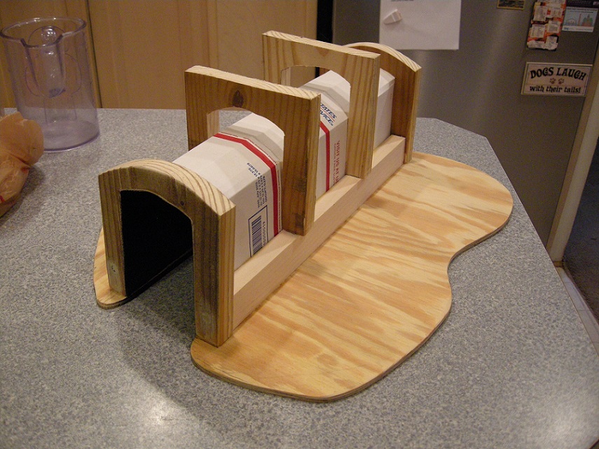

We continue. Cut the base(s) from a scrap sheet of 1/4-inch exterior-grade plywood, then affixed them with a bit of Titebond and a half-dozen cabinet screws.
Base attached
Base attached
HL project d.jpg (219.07 KiB) Viewed 297917 times
At this point, it's probably strong enough to stand on, lol.
Gave the tunnel liner a quick spray of satin black, and sanded the portals flush.
Next up, the "plateau". I have cut one, but I'm not sure it's large enough to keep the scale similar to Howard's. Might think on it for a few days.
