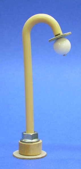

  • Click for bigger photo.A cheap plastic coat-hanger, the kind you get ten for a dollar at the "Dollar Store." In the photo to the right, you can see that I have already "sliced and diced it."

  1. Predrill the base. Drill a hole in the "fat part" of the base that is just big enough to accept the hanger material.
  2. Click for bigger photo.Predrill the post tip. Although some of these hangers actually have a hollow place or "air bubble" at the center, you will probably need to pre-drill a hole in the curved end of the hanger piece for the straight pin to go into. It's possible to do that a speed drill and the smallest diameter nail you can find. Try not to drill so deep or wide that the straight pin wobbles when you insert it, though.
  3. Glue the post together, except for the bead. Keep an eye on it while it's drying to make sure nothing slips out of place.
  4. When that glue is very dry (overnight is best) paint the post all over. Black or dark green are the most typical colors for this sort of lamp. Lionel sometimes used silver as well.
    When paint is dry, give the lamp post several light coats of the clear, glossy acrylic finish. Give time between coats to dry to touch, so you don't get drips or streaks.
  5. Stick the bead and straight pin on and glue in place.
