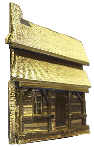

Building flats can add ealistic interest in less than 3/8-inch of space. Click for bigger photo.Return to Big Indoor Trains(tm) primer pageOn30 Display Trains

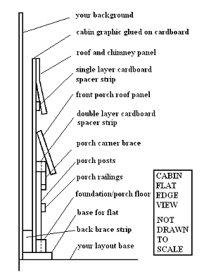

This is a “layered” glue up project. The “layers” add just enough depth and show actual shadows. When viewed from straight on, or just to one side, it looks much deeper than 1/4-inch.

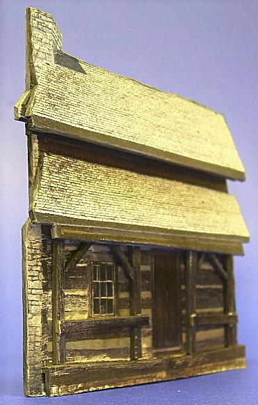

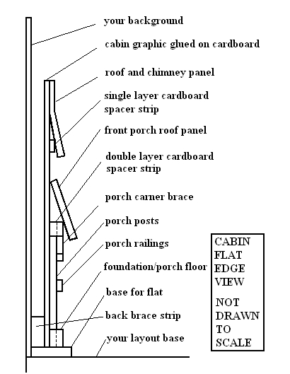

Click for bigger picture.Assemble
  1. Glue one of the extra strips of cardboard at the bottom edge of roof line to provide the base for the roof.
  2. Glue the other extra strip of cardboard above the door to provide the base for the porch roof.
  3. Glue the strip that represents the foundation and porch to the lower edge of the cabin profile.
  4. Glue the strips that represent the porch columns, braces and railings to the cabin profile.
  5. Click for bigger photo.Glue the "cut-out" of the roof and chimney over the roof and chimney on the cabin profile.
  6. Glue the roof piece without the chimney so that its lower edge lines up with the strip of cardboard above the door - this becomes the porch roof.
