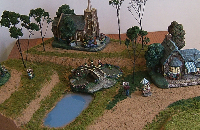

Adding Lakes or Rivers - Here are a few of the many ways of adding the appearance of a lake, pond, or river to an indoor railroad or community:

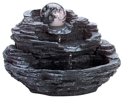

Pre-built Miniature "Desktop" Waterfalls
A few years ago, I found one of those little "office waterfall" fountains that was just the right size to add a waterfall to a temporary display village. Versions that are realistic enough to use with an indoor railroad or village are hard to come by, but you might keep your eye out for one.

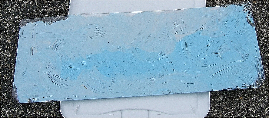

Lucite or Plexiglass Scrap
The next time you're visiting the hardware store, check the window department to see if they have some odd sizes and shapes of Lucite or Plexiglass they'll let you have cheap. (Most stores hang onto pieces that broke off at a funny angle in case someone comes in wanting a little tiny panel. Some stores save the odds and ends for schools that have requested them, so if you tell them it's for a craft project, that usually helps.) You can use glass, but that can get dangerous, especially on larger pieces.
When you get it home:
- Figure which side you want to be the top (usually the side with fewer scratches; there may be a plastic film protecting one side - if so that side will probably be your "top." You'll have to take the film off before you paint, though, so you can see what you're doing.).

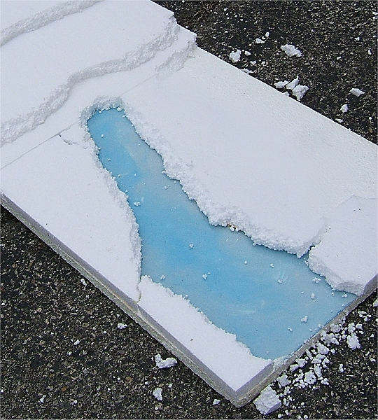

- If you want a goofy shape and you know how to cut Lucite, go ahead and cut it to the shape you want. If you don't want to mess with cutting it, though, don't bother. You can always cover the excess with fake snow, rocks, styrofoam "snow banks" or whatever later. Just keep the "final" shape of your watercourse in mind as you paint it. (For more information on using foam "scenery," see the article Portable Indoor Displays for Trains and Towns.)
Paint the underside, with acrylic craft paint or latex house paint (interior or exterior are fine). These have the advantage of being easy to mix, and also of not being entirely permanent in case you feel you screwed it up and you want to rinse it off and start again.
- For icy water, use a pale bluish-gray around the outside edge and a deeper blue in the middle. If you want the whole bit to look frozen, you may use the pale color throughout, but allow the tone to vary slightly so it doesn't just look like you spray-painted it. The lucite panel in the photos to the right received a mix of gray paint from my daughter's room, white paint from our kitchen, and blue acrylic craft paint from a craft set.
If you are eventually going to use this on top of something white, like a white cloth or a piece of white styrofoam, you don't even have to cover 100%. The brush strokes can represent ice scratches, and the "deeper" white showing through will add depth. Don't worry about "too much" texture showing in your brush strokes. As the photos to the right show, the texture is less obvious when you turn the panel over.
- For warm water, use a brownish green around the edge and fade to a deeper blue in the middle. If you're going to use this in a permanent display, you could add more apparent depth by allowing the coating on the lucite to be semi-transparent, leave a slight gap above the surface underneath it and paint that surface a slightly darker color. But I've gotten good results by just giving it a good opaque second coat and laying the lucite right on the surface as well.
After the paint has thorougly dried (overnight if you use two coats), place the panel where you want it. If you are glueing it down permanently, glue it down by the edges (otherwise you may disturb your the paint job where it will show.
- Disguise the edges however you feel most comfortable (fake snow, "craft rocks," aquarium gravel, styrofoam "snow banks," etc.
When you're all done, you may not find it entirely convincing. But when people keep sticking their fingers into the "water" to see if it's really wet, you'll realize that, with the edges hidden, it really does look like a body of water to most people.
