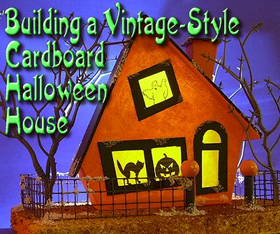

Building a Vintage-Style Cardboard Halloween House
Paul has asked me to tell you how I made the building that shows in the title photo. It's a "family-friendly" Halloween house that will eventually be part of a village for my grandchildren.

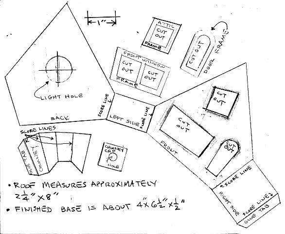

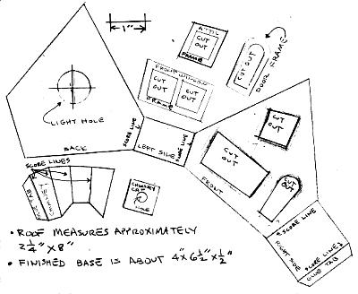

Printing the Plan
Double-click on this image to see a higher resolution pattern.
Double-click on the plan above to see a blow-up. You should be able to print the big version at the size you need.
  • If you have Adobe Acrobat Reader on your computer, click here to open the pdf version. Select the print option, tell it to "auto rotate and center" or whatever else you need to make it go to Landscape mode. Don't select the "scale to page" or "shrink to fit" option. Print.
  • If you don't have Adobe Acrobat Reader on your computer or for some reason that doesn't work, open the big JPG version. Choose the "file, page setup" from your browser. When the page setup menu comes up, select "landscape mode." You should also choose the "print to fit" option if you have one. If you don't have a "print to fit" option, you may have a margin setting option. Set the margins to 1/4" if you can and print.

  1. The house, chimney, and chimney cap (and the roof, eventually) need to be cut from thicker cardboard, such as the cardboard from the back of a writing tablet.
    • Layout the lines carefully.
    • Using a steel-edged ruler as a guide, cut out the shapes with a sharp mat knife or X-acto knife. Watch your fingers.
    • Score all fold lines.
  2. Cut the roof from the same cardboard as the house. It should be about 2 1/4" x 8". The most important thing is that it has an overhang on all sides just like a real house. After you determine where the peak of the roof should be, score the crease.
  3. Cut the door and window frames from thinner stock, such as posterboard or cereal box cardboard.
  4. Locate silhouettes of a ghost, cat, and Jack-o-lantern and print them on yellow bond paper. I got mine from an Internet search. If you want, you can print off the ones that Paul located. Don't use the "resize to fit" option when you print, or you'll get something way too large to use. (If you try Paul's and it comes up the wrong size, download the JPG version and resize it as necessary on your computer.

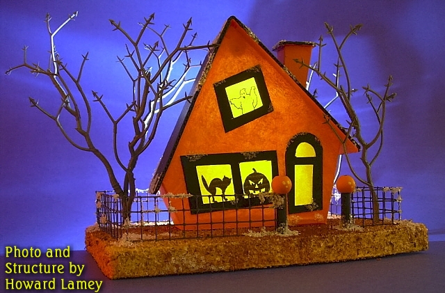

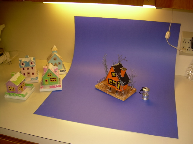

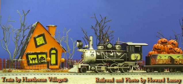

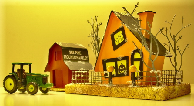

Here's a day shot, a night shot and a pix of my "photo studio"...
Click for bigger photo.Click for bigger photo.
Since making these houses, I have added a yellow moon with a witch on a broom silhouette...the moon is mounted on a black bamboo skewer and is stuck in the base behind the chimney...it added a lot to the scene...

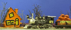

Using With Trains - A few months after I built this, Paul sent me a Hawthorne Village "Nightmare Before Christmas™" locomotive and a few cars. He wanted to give readers a sense of how this and the other Spook Hill™ buildings would look with a commercial Halloween train. (This train and others are described on Paul's Halloween Trains web pages. Click for bigger photo.Except for the holiday paint job, this train is actually an On30 model compatible with Bachmann's On30 trains, which were designed to look good with Christmas villages. Most HO trains would be a little smaller, and most Lionel trains would be a little bigger, so this should give you a pretty good idea of whether it will work with your train set.
