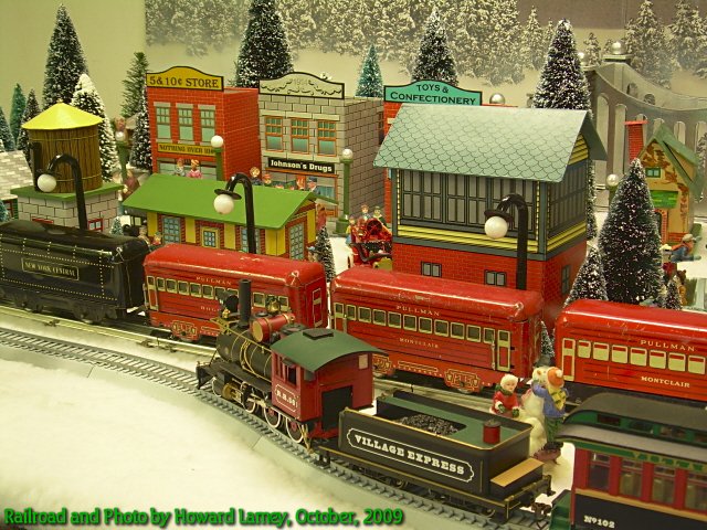

    The title photo shows an On30 train manufactured by Bachmann for Dept. 52 between 1999 and 2008 "chasing" an antique O gauge Marx train. They look better together than you might think they would, but they certainly won't run on the same gauge of track.

If you have an old O gauge set in the attic that runs, it may also work well visually with a Halloween village. My friend and co-conspirator Howard Lamey uses an ancient Marx set with his seasonal villages, with great effect. Of course you can't order these new, but stores like Trainz.com often have a few pieces to sell.
