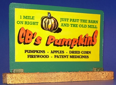

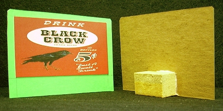

    Attach a Brace or Stand
    Click for a bigger photo.The Black Crow and Hearsey's billboards shown on this project simply have blocks of wood glued on the back to hold them upright. Howard has also experimented with full-length stands as shown in the photo to the right. The stand is made of layered corrugated cardboard, like the base of many of Howard's vintage-style cardboard village. It is then:
    • Wrapped in acid-free white bond paper,
    • Painted a mix of fall colors (such as green, brown, and orange),
    • Given a light coating of sawdust (using Elmer's Glue),
    • Touched up again with fall colors, and
    • Glued to the billboard's supporting wall.
