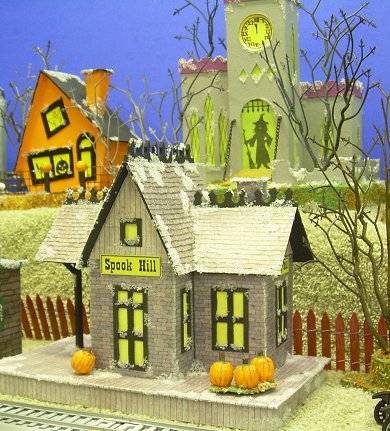

The Spook Hill station. Click for bigger photo.The Spook Hill™ station project is truly unique. It is built like the vintage cardboard houses that were popular Christmas decorations between World Wars. But it also looks good with:
It is also the first Halloween-themed train station I have ever seen. (Yes, with slightly different colors, you could make a Christmas or Easter-themed station, but work with me here.)
This project is not quite a "glitterhouse," because the walls and roof are finished with printed graphic paper instead of paint and glitter. However most of the construction is very similar to building a glitterhouse, so we will refer to articles on glitterhouses in general from time to time.

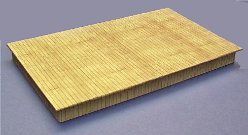

The base is a rectangular "box" that is built up from layered corrugated cardboard and capped with a slightly larger platform.
    Click for slightly larger photo - sorry, we don't have a really big one this time.
  1. Make the base from four layers of corrugated cardboard glued together in a sandwich.
  2. Click for bigger photo.Cut the platform from a single heavy piece of solid cardboard, like the cardboard from the back of a legal pad, or else a fine corrugated cardboard like they use on Post Office Express Mail boxes.
  3. Wrap and glue a strip of cereal-box cardboard all around it to camouflage the rough edges of the corrugated cardboard. (The two photos to the right are from another project, but they give the idea.)
  4. Click for bigger photo.When the basic "box" is built, cover it with white bond paper just like you would wrap a gift, except that all surfaces of the paper cover must be glued down to the box. A glue stick works great for this.
  5. Cut a piece of the T-111 pattern (or other pattern of your choice) that will cover the top of the platform and leave at least a half-inch overlap all the way around. We had to use two pieces to make it long enough. The board pattern should be perpendicular to the length of the platform.
  6. Click for slightly bigger photo. (Sorry we don't have a really big one. You'll figure it out.)Glue the T-111 pattern onto the platform, wrapping it around the edges as precisely as you can and gluing it down firmly all the way around.
  7. Cut strips of the T-111 pattern wide enough to cover the edge of the base. The board pattern should be perpendicular to the length of the strip.
  8. Glue the T-111 pattern around the edge of the base.
  9. Glue the platform on top of the base.

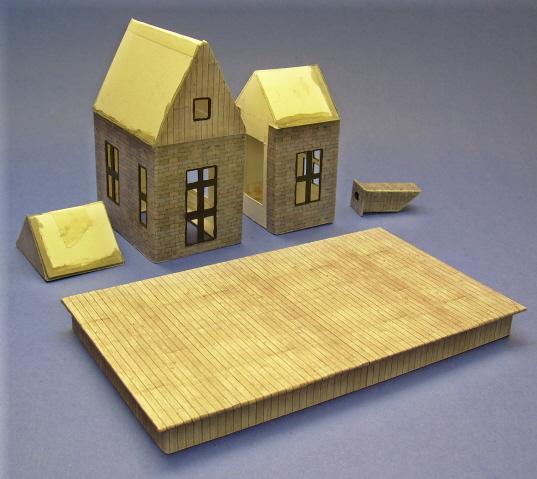

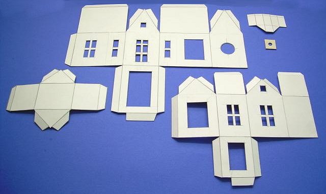

  1. Transfer the patterns to cardboard.
  2. Score the fold lines of the station walls, then cut out that piece and fold on score lines.

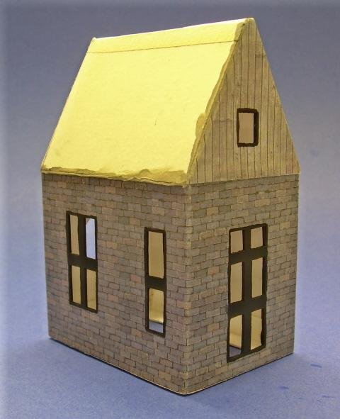

  3. Assemble and glue each section of the station but don't glue them together yet.
  4. Click for bigger photo.Using black acrylic paint, paint the window and door frames and the exposed edges of cardboard that will not be covered when the printed siding and roof are applied.
  5. Apply the printed graphics of the siding and gable. Do a section at a time. Measure carefully, make crisp folds, apply glue and press in place. You're better off leaving the graphic paper a tad long than a tad short.
  6. Trim the edges of the graphic paper, if necessary.

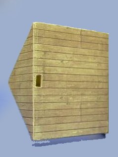

    The photo to the lower left shows the underside of the roof overhang section. The T-111 siding pattern has been applied to the "ceiling" to give it a "porch ceiling" effect. This piece has also been notched to accept the support post that is shown in the detail below. The photo to the lower right shows the major station components, each glued together, with windowframes painted, and graphics paper applied.

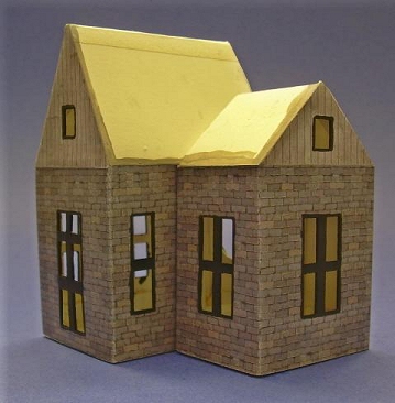

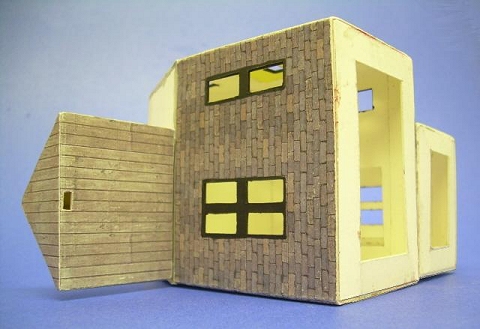

  7. Glue the "right wing" to the center section (shown at the left below). The "back wall" of the right wing should line up with the back of the center section.

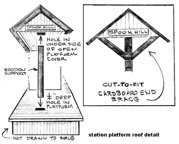

  8. Make a wedge-shaped cardboard brace to fit between the roof of the main section and the roof of the open section. You can use the small roof pattern to get a started on the basic shape, but you will have to cut it to fit. This may take couple of tries to get the size exactly right. See the right photo below for an example. When you're certain you have the right fit, glue the brace to the roof of the main section and let it dry. Then it will be relatively easy to attach the "left wing" overhang.

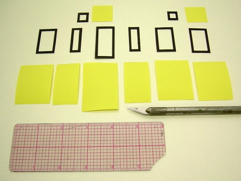

  9. Cut out the window-frame and door-frame pieces and whatever you are using for "glazing." Check the fit of the window and door frames, then paint them. The right photo below shows how these pieces should look when they're ready to apply.

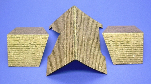

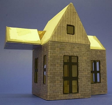

  10. Cut out the roof pieces. Score a fold line for the peak. Put the peak of each roof section on the high point of the section to check the fit. You may have to make more than one roof to get best fit.
  11. Click for bigger photo.When you are sure you have a good fit, cut and apply the shingle graphics for each piece.
  12. When that is dry, paint the underside of the roof overhang.
  13. Glue the roof pieces to the structure.

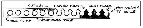

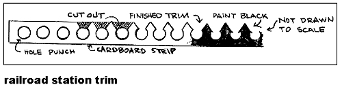

  15. From a strip of rigid cardboard, create the roof trim. You start this process by punching a series of holes in the cardboard strip as shown below. We have no scale drawings for this part of the project because the size of the cardboard strip you use and the distance between the holes depends on the size of your hole punch. When you are through, cut diagonal lines in the cardboard as shown to create a gingerbread pattern. By the way, this "trim" served real functions on old train stations - it discouraged pigeons, and it usually served as an extension of the lightning rod system.
  16. Cut the lengths of "roof trim" you will need and paint them. When they are dry, glue them to the roof.

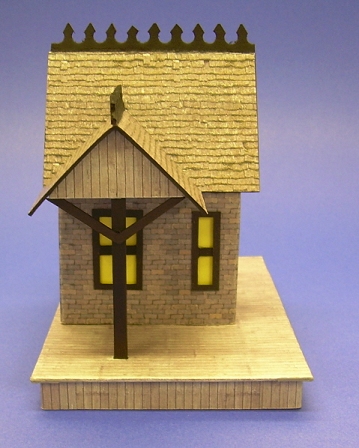

  18. Before gluing the station to the platform, determine where the supporting post for the overhanging section will need to go and cut a hole for inserting the end of the post. The drawing below shows how this piece will be installed eventually. The photo below shows how the post and braces will look when they are completely installed.
    Click for bigger picture.Click for bigger photo.
  19. Click to see full-sized PDF graphic file.If you wish, you may print the Spook Hill signage, cut out some signs you like, glue them to card stock, cut out the card stock, touch up the edges with a black marker, and glue them to the building. The graphic page has some extra signs you can put on other projects you build later if you wish.
  20. Glue the station to the base.
