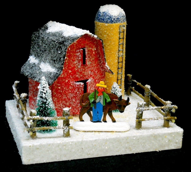

How about a ladder made from 1/4" grid galvanized hardware cloth?...see the ladder on the silo...I cut with flush cut tin snips and filed the sharp edges off...and you could bend top like a caboose ladder...
quarter inch grid hardware cloth ladder.JPG (162.88 KiB) Viewed 2015385 times

The 1/4-inch hardware cloth idea was brilliant, Howard:
I didn't make the big loop on the top, thinking that might look weird (although it would certainly have made it easier for someone to climb up there).
