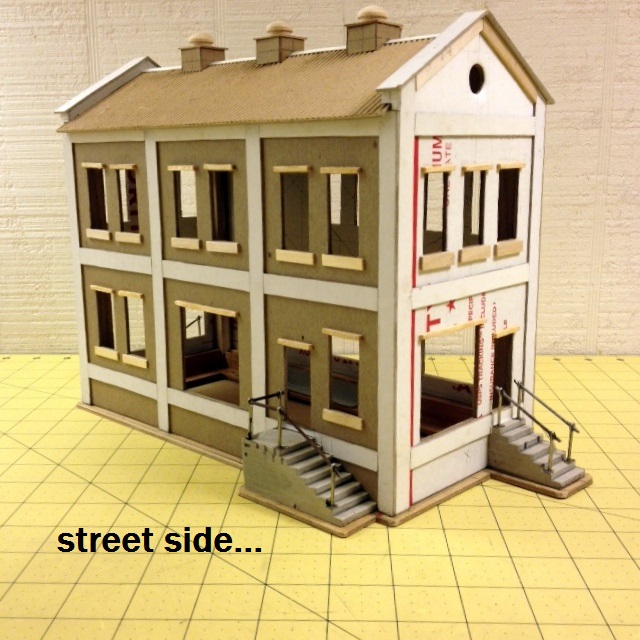

This building is based on lots of Google search images…I guess you would call it “coarse scale architecture”…it is sized to go with the few Lionel pieces I have plus my Marx litho tin trains…the base is approximately 5” x 11”…overall height is about 9”…

I could not find cork tiles locally…so I used my old stand by -- “cardboard“…including recycled priority mail boxes (the kind with the small corrugated flutes)…three ring binder cover cardboard (after removing the vinyl skin)…also match sticks, coffee stirrers plus other odds and ends…the window mullions will be ¼” hardware cloth with cereal bag plastic glazing…wire step railing have stanchions made from cotter pins…there are still some details to make before primer, finish and final assembly…

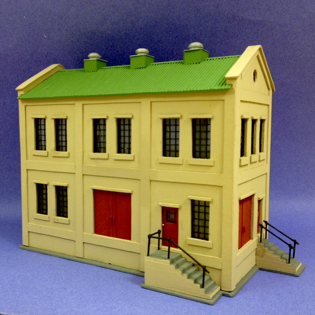

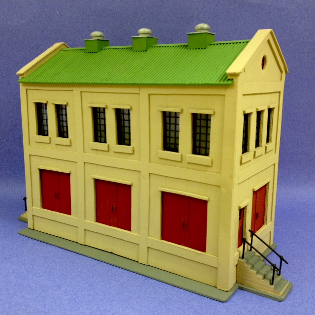

finished...for the most part...still some details and a few coats of clear satin spray to protect the finish...
Re: Warehouse-industrial building-small factory project...
Wow, that is tremendous, Howard...it will look great together with tinplate trains!
