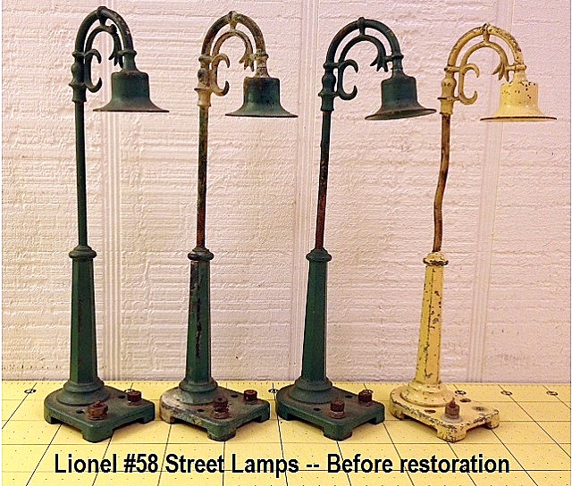

Greetings to all...
Very soon I will be starting my own restoration of four of these vintage street lamps...(I really only have room for four)...I'll be posting the topic over on one of Paul's other sites...the Cardboard Christmas Forum...and I'll post a link here...
Wish me luck...Howard...
Re: Restoring Lionel #58 Gooseneck Lamps
greetings to all...
my project has started...here's a link to the topic on the Cardboard Christmas Forum...
http://www.cardboardchristmas.com/forum ... f=2&t=1117
- Attachments
- street-lamps-before.JPG (173.08 KiB) Viewed 1094736 times

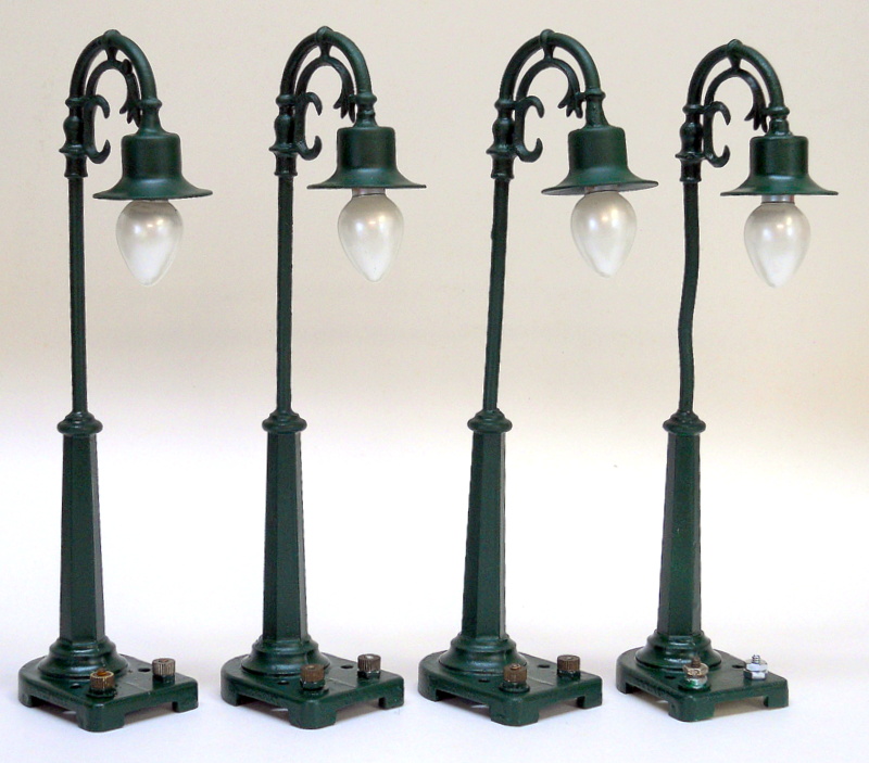

greetings to all...
this has been a fun project...and i'm finished with everything except the wiring harness...(more about that later)...
just a couple of notes...before cleaning, priming and spray painting i had to do a few repairs to get them to illuminate...this involved the following...
re-soldering a loose shade and epoxy a crack where a shade meet the downturn of the bent top tube...rebuilding and rewiring one socket...replace a few of the wiring terminal nuts and bolts...re-insulate two terminals...
then checking and rechecking the connections to make sure all the lamps burned...i am looking for two vintage knurled brass nuts to replace the modern bright ones on one of the lamps...i also ordered a handful of reproduction pearl color bulbs...
the final finish was two light coats of Rust-Oleum® American Accents Semi-Gloss Hunter Green spray paint...
now it's on to another project...that's no surprise to anyone i'm sure...
- Attachments
- lionel-58-street-lamps-reconditioned-ccf-bitf.JPG (164.54 KiB) Viewed 1094676 times
Very nice Howard...they will look great on the layout/display!
They look fantastic, Howard!
