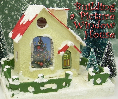

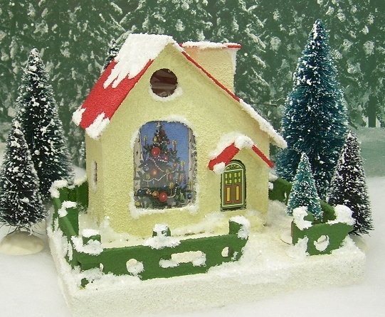

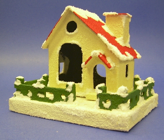

Click for bigger photo.Building a Picture Window House
One of the relatively rare kinds of "putz" (Christmas cardboard village) houses was the "Picture Window House." This structure included a large front "window," that displayed a Christmas scene of some sort.
The main differences between this project and the starter project are the picture window and that we have added a textured finish using sand.

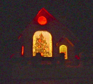

We included this photo so you could get some idea of how the picture window looks in a darkened room.  Click for bigger photo. What You Will Need

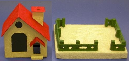

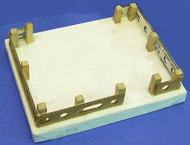

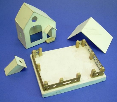

Building the Base and Fence
The base is a rectangular "box" that is decorated before the house and trees are installed. For this project, it should be about 4" x 5" and about 1/2" high.
Cut the Base and Fence - For this project, I cut the base and fence out at the same time. The base is made from heavy corrugated cardbard, the kind they use in big boxes. The fence pieces are made from fine corrugated stock, like that from the small express mail boxes you get at the post office. The same kind of fence can also be cut from heavy card stock such as back of a writing tablet. If you wish, you may use different materials for the fence, such as a miniature wooden snow fence from the craft store or a rustic rail fence you make from twigs.
To cut the inside part of the fence, use a hole punch as shown in the plans. Then use a straightedge and Xacto knife to connect some of the holes to get the open oval shapes.
Glue The Base - Build the base up from layers of corrugated cardboard glued together in a sandwich. You then wrap and glue a strip of thin poster-board or cereal-box cardboard all around it to smooth over the rough edges of the corrugated cardboard.
Wrap the Base - When the base is built and the glue is dry, you cover it with white bond paper just like you would wrap a gift, except that all surfaces of the paper cover must be completely glued down to the box. A glue stick works great for this.
The finish coat of paper is glued down everywhere so it becomes a part of the surface and recreates the pasteboard finish of the original glitterhouses. Click for bigger photo. Click for bigger photo
Note: More details about building bases are provided in our article: Building Glitterhouse BasesClick for bigger photo.
Attach the Fence - When the glue on the base has dried, glue the fence pieces to the base.
Prime the Base and Fence - When all the glue has dried, paint the base with the flat white paint. This provides an even finish that will hold the acrylic paint and glitter. If the fence has cardboard in it, prime it, too.

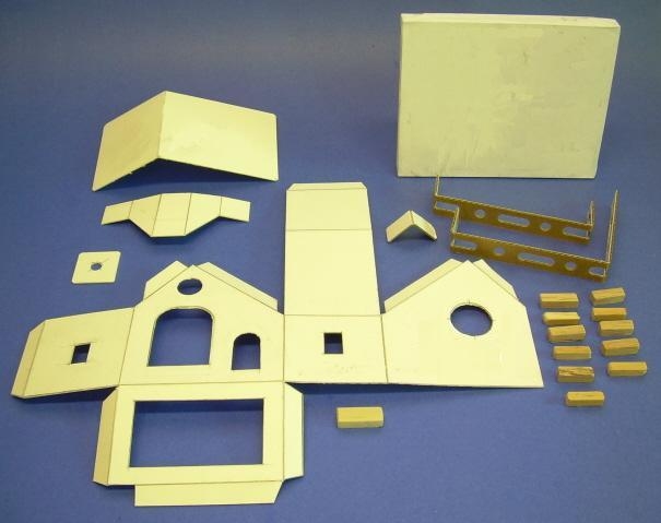

Cutting Out the Structure Pieces
  1. Carefully transfer patterns of all pieces to the cardboard building stock. A .05 mm lead mechanical pencil and a “C-Through” brand ruler make this accurate and easy.
  3. Score the fold lines before you begin cutting out the parts (although you may score the roof pieces later, if you wish, after you've checked the overhang). Use the metal ruler or other steel edge as a guide.

  1. Using Elmer's white Glue-All or a similar product, assemble the house pieces.
    White glue works best if you apply a thin coat to each mating surface and wait a few moments for the glue to become tacky. Do not glue the house to the base yet.
  2. Glue the chimney and chimney cap together.
  3. When the glue is dry and you feel that the structure is "sound," double-check the roof size. The most important thing is that it has an overhang on all sides just like a real house. After you determine where the peak of the roof should be, score the crease. Make any adjustments to the outside shape of the roof as necessary, and glue on the roof.
  4. When the glue for the roof is dry, glue on the chimney.

  11. Paint the house in your choice of colors. Don't glue the house to the base yet, though.
  12. Paint white patches for "snow" on the roof and chimney. The photo to the right gives some ideas for varying the "snow" pattern on a series of houses. Note Howard's signature 'Dr. Seuss' color choices and white paint 'globs.'  Click for bigger photo.Once you get good at this, you could combine this step and the next by using a 50/50 mixture of white paint and Elmer's glue, then sprinkling on the glitter before the paint/glue mixture starts to dry. At first you may want to do this in two separate steps, though.
  13. Click for bigger photo.If you haven't already put glitter on the "snow," add it now. Brush on a thin, but even coat of undiluted white glue over a white patch on the building and sprinkle on the clear glitter. Don’t try to do the entire house or base at once. White glue starts to film over and dry quickly so just do a section at a time. The glue dries clear, so don’t judge the final look until the glue is dry.

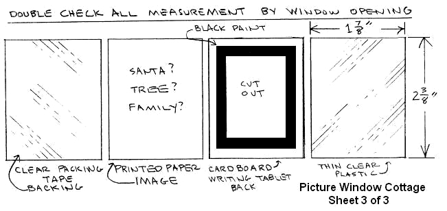

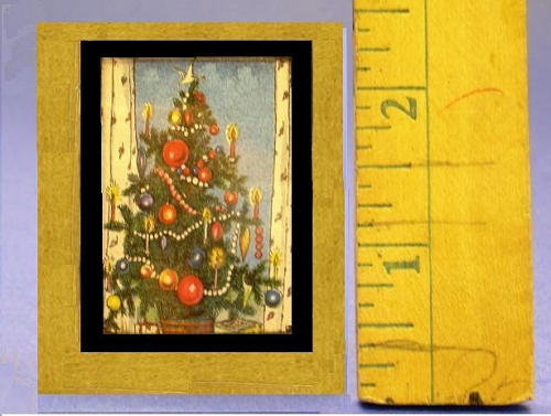

Make your Picture Windows
Decide on and print a graphic the size you need it. We've put a few here, but you can get more by scanning old Christmas cards or "googling" Christmas images on the Internet.
For your convenience, we've provided a .pdf version of each that is prescaled to go with the building plans on this page. We've also provided a .jpg version that you can resize if you need it in another scale.
Click to download presized .pdf file Click to download presized .pdf file Click to download presized .pdf file
Download presized .pdf file Download presized .pdf file Download presized .pdf file
Download .jpg file Download .jpg file Download .jpg file

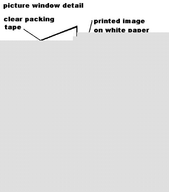

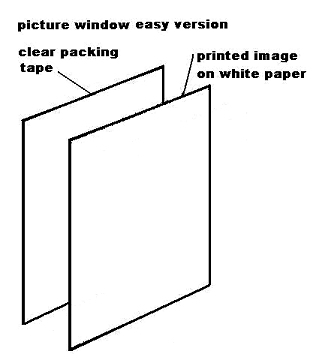

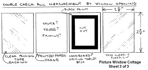

When you have your graphic ready to install, build the "picture window" as shown below. I've used two basic approaches. Good - Click for bigger picture.There are two ways to do this. The easiest is to find a graphic you like, print it the right size on your color printer, stick it onto a piece of clear packing tape, and glue it into place inside the building.
[Note from editor: I believe Howard turns the "unprinted" side of the graphic toward the packing tape. You may be tempted to put the tape on the printed side of the graphic, which would give a shiny surface and protect the graphic from handling damage, but I'd be afraid the tape would yellow faster than the "non-yellowing" paper you printed the graphic on. Also, depending on the printer and upon the kind of "vellum" you have access to, you may also be able to print the graphic on vellum and use that with or without the packing tape. Experiment as much as you want - this is a relatively inexpensive hobby. - Paul]
Better - If you have access to clear, thin plastic or some similar material that you can use as a "windowpane," consider making a "sandwich" picture window. This version provides more sense of depth, and the clear plastic "windowpane" protects your graphic.
This version provides more sense of depth than the 'easy' version shown above. Click for bigger picture.

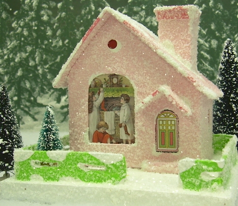

Assemble the House
  1. Try your picture window out for "placement" before you apply glue. Once you're satisfied with the optimum placement, draw a guide line on the inside of the house, and glue the picture window in place with white glue. You'll only have a few seconds before the glue starts to set up, so be certain it's where you want it, then hold onto it for a minute or two to be certain it's going to stick before you set it down - you don't want it to slide down and wind up glued in the wrong position.
  2. The paper door I used is available from This is a sample pack from 'Papa Ted' Althof's authentic line of reproduction doors and windows for putz houses. Click to see his product page.www.papatedsplace.com He has a full line of reproduction doors plus red “cellophane type” and paper windows. Ted’s site is the only place I know of for these, all of which are exact copies of vintage ones.
  3. Glue the other window and door covering material on the inside of the house. I use colored velum or colored “cellophane type” material. Red seems to be the traditional color but you can use any color you like.
  4. Glue the finished house to the finished base. Fill in any gaps between the house and the base with white glue and sprinkle on more glitter.

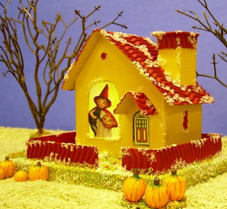

Click for bigger photo.Bonus - Halloween Graphics
Here's an example that shows just how flexible these designs are. The version to the right doesn't use the sand finish, uses sawdust instead of glitter on the base, and it uses a different kind of cardboard for the roof (taken from a Starbuck's-style coffee cup). You can see that by using colors suitable for Halloween and substituting a Halloween-themed graphic in the "picture window," you can have a nice Halloween-themed structure.
