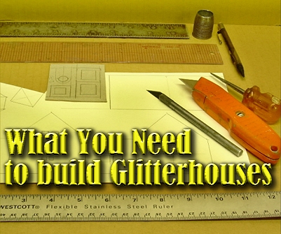

What You Need to Build Glitterhouses. This is how Howard Lamey arranges his tools before he starts cutting out his next project.  Click for bigger photo.Return to Big Indoor Trains(tm) primer pageOn30 Display Trains

Basic Tools
These are the core tools that every glitterhouse builder should keep on hand:
  • Mat knife (Change blades often)
  • X-acto knife (With # 11 blades)
  • Pencil (Get a 0.5mm lead mechanical pencil)
  • Eraser
  • Ruler (Try the “C Through” brand)
  • Steel ruler
  • Small steel square
  • Scissors
  • Elmer’s Glue-All
  • Glue stick
  • Cutting mat
  • 1/4-inch hole punch
