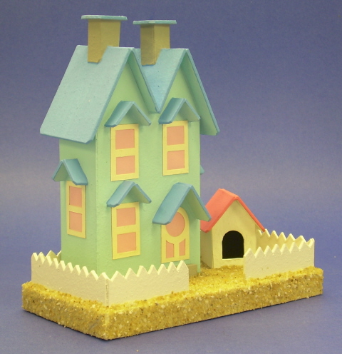

Howard Lamey recommends this simple cabin a a good beginning 'putz house' project. Click for bigger photo.Return to Big Indoor Trains(tm) primer pageOn30 Display Trains

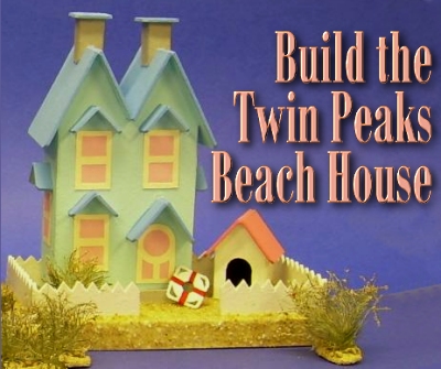

Building the Twin Peaks Beach House
This project is a followup to our Sandy Shores™ Lighthouse project that was published in January, 2009. We have finished this house in "seaside" colors that are typical of seaside houses in many parts of the United States. If you like the shape, of course, you are certainly welcome to use other colors and refinish it for a Halloween or Christmas village. If you do make one, please send us photos, that's our best reward for providing these projects.

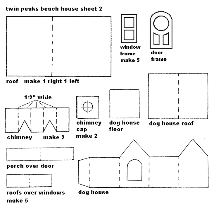

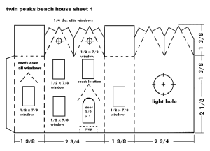

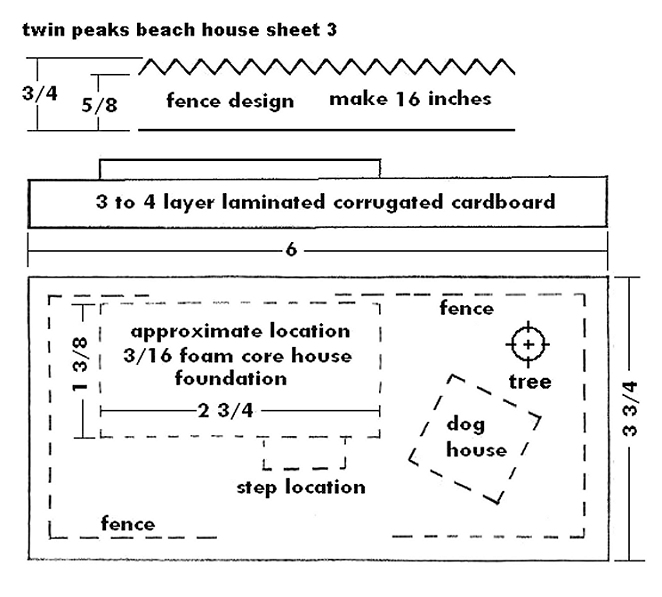

Printing the Plans
Double-click on this image to see a higher resolution pattern.Double-click on this image to see a higher resolution pattern.
Double-click on the plans above to see the large versions. You should be able to print the big version at the size you need either of the following ways.
  • If you have Adobe Acrobat Reader on your computer, click the following links to see the PDF versions:
    Select the print option, tell it to "auto rotate and center" or whatever else you need to make it go to Landscape mode. Don't select the "scale to page" or "shrink to fit" option. Print.
  • If you don't have Adobe Acrobat Reader on your computer, or for some reason that doesn't work, open the big JPG versions by clicking on the reduced plans above. Choose the "file, page setup" from your browser. When the page setup menu comes up, select "landscape mode." If you CAN choose to NOT scale the picture, do so. This may mean that part of the page gets clipped on your printer, but the plan should sprint to the right size. If they don't you should be able to tweak the size either in the print program or in any graphic program you have on your printer.

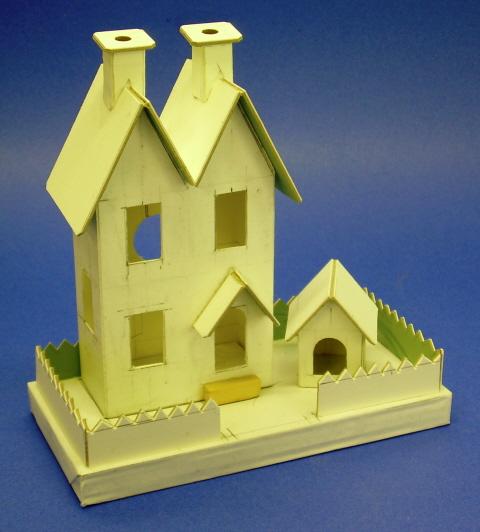

The base is a rectangular "box" that is decorated before the house and doghouse are installed. For this project, it should be about 6" long, 3 3/4" wide, and about 1/2" high.
Note: For this project, I cut the base and fence pieces out at the same time. The fence pieces are made from thick card stock such as the back of a writing tablet. If you wish, you may use different materials for the fence, including miniature wooden picket or snow fence from the craft store or a rustic rail fence you make from twigs.
Cut And Glue The Base - Usually the best method is to make a base from layers of corrugated cardboard glued together in a sandwich. You then wrap and glue a strip of thin poster-board or cereal-box cardboard all around it to camouflage the rough edges of the corrugated cardboard.
Wrap the Base - When the base is built, you then cover it with white bond paper just like you would wrap a gift, except that all surfaces of the paper cover must be glued down to the box. A glue stick works great for this.
The finish coat of paper is glued down everywhere so it becomes a part of the surface and recreates the pasteboard finish of the original glitterhouses. Click for bigger photo. Click for bigger photo
Note: For this project I also added a sub-base for the house and doghouse. These are rectangles of thick corrugated cardboard that fit just inside the bottom edge of those structures (you'll need to trim them to fit). They give the structures more strength, and they provide more area to hold glue when you are gluing the structures to the base. In the photo below, you can see that I glued the house's sub-base to the base before I painted the base. Later, I glued the house down around it.
Note: More details about building bases are provided in our article: Building Glitterhouse Bases
Click for bigger photo. Attach the Fence - When the glue on the base has dried, glue the fence pieces to the base.

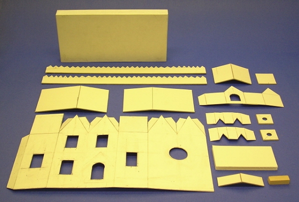

Prepping the Structure Pieces
The house, roof, chimney, and chimney cap need to be cut from thick cardboard, such as the cardboard from the back of a writing tablet. The roofs could be made of picture frame matte board
  1. Carefully transfer patterns of all pieces to the cardboard building stock. A .05 mm lead mechanical pencil and a “C-Through” brand ruler make this accurate and easy.
  3. Score the fold lines before you begin cutting out the parts (although you may do the roof parts later, if you wish, after you've checked the fit and the overhang). Use the metal ruler or other steel edge as a guide.
  5. Double-check the roof size. The most important thing is that the two pieces meet nicely in the middle. The roof should also have a fairly even overhang on all sides. After you determine where the peak of the roof should be, score the crease.
  6. Cut the door and window frames from thinner stock, such as posterboard, cereal box cardboard, or colored card stock.

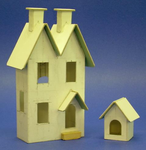

  1. Click for bigger photo.Using Elmer's white Glue-All or a similar product, assemble the house, glue on the roof and chimneys. I would do this in steps, clamp the pieces, and let them dry so that you are not trying to hold, tape, or clamp a lot of small pieces at one time.
    White glue works best if you apply a thin coat to each mating surface and wait a few moments for the glue to become tacky. Do not glue the house to the base until you have applied the sand (below).
    I did not apply the little "awning" roof pieces or windowframes until I had painted the structures and doublechecked the fit, so they're not shown in all photos.
    Click for bigger photos.The photo to the right shows the house and doghouse set in place to make certain that they fit where they're supposed to before we paint everything and glue it together.
  2. If you have cut the door and windowframes from cardboard stock, glue them on now, then glue on the awnings. I left those details until later, since I used colored card stock for the door and window fraimes.

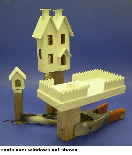

  3. Click for bigger photo.Prime the house, doghouse, base, and fence with flat white wall paint. Don’t skip this step; it gives you a uniform surface for painting the final coat. The photo to the right shows how I set the pieces on improvised stands so they could dry all the way around at the same time.
  4. Paint the house in your choice of colors. I use acrylics from the Wal-Mart craft department.
  5. Finish and glue on any remaining trim details, including door and window frames and awnings.
  6. Paint the base and fence. The base should be beige or sand color, something that will blend with the sand once you glue it on.
  7. Finished house ready for accessories.Glue sand on the base. Brush a film of white glue on an area, then tamp down the sand into it. The glue dries clear, so don't judge the final effect until it's dry. You should probably count on doing this in at least 3 stages - if you try to do it all at once, you'll probably just make a mess you have to redo again anyway.
  8. Glue the window "glazing" material you have chosen on the inside of the house.
  9. Glue the finished house and doghouse to the finished base. Fill in any gaps between the house and the base with white glue and sprinkle on more sand.

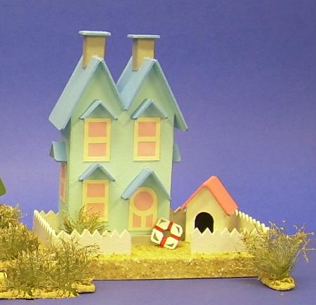

  10. Add accessories that suggest a beachfront property.
