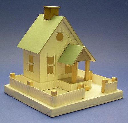

When the glue on the base has dried, try the fence pieces and porch foundation on the base for a fit, but don't glue them down until you've tried the house pieces on for a fit as well.

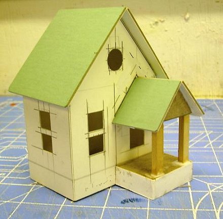

  1. Click for bigger photo.Using Elmer's white Glue-All or a similar product, assemble the house, glue on the roofs and chimney. I would do this in steps, clamp the pieces, and let them dry so that you are not trying to hold, tape, or clamp a lot of small pieces at one time.
    White glue works best if you apply a thin coat to each mating surface and wait a few moments for the glue to become tacky. Do not glue the house to the base until you have applied the sand (below).
    Click for bigger photos.I did not apply the windowframes until I had doublechecked the fit, so they're not shown in all photos.
    The photo to the right shows the house set in place on the base to make certain that they fit where they're supposed to before we paint everything and glue it together.
